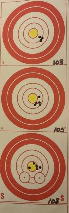

I built a 6mm ARC rifle on a Bighorn Origin action, 28” Shilen barrel with a 7.5 twist and a MDT XRS chassis. I can’t find any 6mm ARC brass, so I purchased loaded ammo from Hornady in 103 gr, 105 gr and 108 gr. Shot at 100 yards and produced the following groups. Factory ammo was just ok with the best group by 103 ELDX @ around .3 moa. Rifle will be used for a light recoiling rig at 1000 yard steel. Only got speed with the 108’s at 2762 and a SD of 12. Very happy with the light recoil and should be able to spot shots easily.

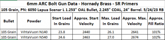

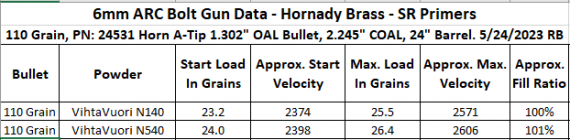

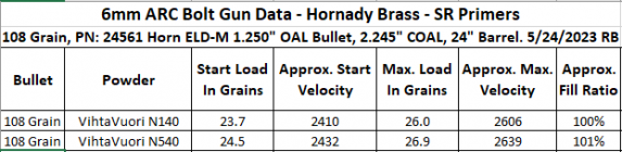

If you were interested in VV powders I sent them a message to get some load data for their powders with 105, 108 and 110grn bullets. Here it is. This is for bolt guns. '

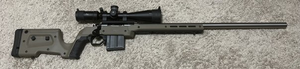

Yes using MDT magazines and they work just fine. We’ll get a picture of the Rifle in the morning hopefully.
