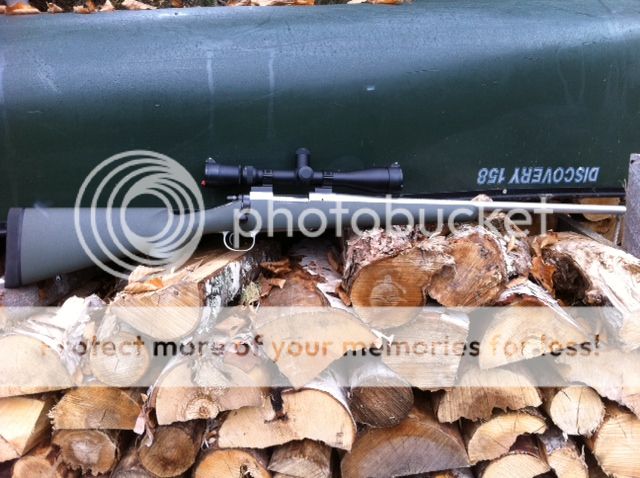

No reason for me not to go 1-8", as I don't have the barrel yet. The idea is to build an off season twin to my 7mm Rsaum.
