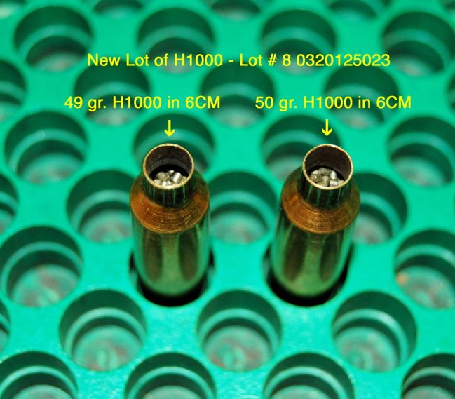

50grs. H1000 in Winchester brass fired 5 times comes up to the shoulder/body junction in my cases. Not sure why it is so high in Robert's photos, interesting.

All I know is I have an 8lb jug of it and it seems to take a ton of it to get any velocity. I had no information on how high others H1000 stacks, but mine is as shown in the photos (and that's why I made the posting on it because I don't mind a little powder compression but I'm doing some serious crunching to load with that and it bothers me to compress that hard).
FYI - On a whim, I have ordered another 8 lb jug of H1000 - I hope this changes things or something just does not add up.
The case capacity for the brass used in the photos has 55.3 gr. of water capacity (it's 4x fired Winchester brass re-sized with the 243 Egolf Imp. re-size die I got from Joe).
Do your case capacities fall in line with my reported case water capacity for the 6CM?

Ways to aid/help in "powder crush" is the manner of which one pours the charges into the case, and the length of the funnel used.
By pouring our charges "slow" and to "the side" of a funnel increases powder room. Using a 6", 10", or longer drop funnel with a "slow to the side" manner, greatly increases the room even more. The amount of "powder crush" can be minimized by simply pouring the powder charges slow with a drop-tube type funnel.
Happy Shooting
Donovan Moran
Donovan
Agreed and understood. If I do a fast pour with 51 gr of H1000 in my 6CM, it's actually slightly mounded up at the mouth of the case, but I don't do that with H1000 because the grain size is big enough it becomes prone to bridging in the funnel. I used a regular powder funnel and poured it at a rate where it does not bridge, then tapped the case a few times. Could I use additional measures to settle the powder more? Yes. Do I want to get into special powder handling techniques when loading? No. With loads like that in that case no matter what you do there's going to be compression.
Thanks for you input and info.
Robert
Hi Donovan
Actually, I don't normally tap cases but I did so for the pics in the photos to settle the powder some (more than it was after just being slowly poured down the side of my powder funnel). So what you see in the photos is more settled than what you might see if I just poured it.

Robert brings up an important point. The 6CM does allow for the use of H1000, but from the pics, 50grs of H1000 is about it. What kind of velocity is the average user getting with 50grs of H-1000? Roberts Ohler is saying 2990FPS with a 105 Hybrid. This may be important to some.

Well, a box from Powder Valley showed up today with a new jug of H1000 (Lot #8 0320125023) and this is definitely different than the other jug of H1000 I have. 49 gr and 50 gr of powder is definitely more compact than the other jug. Below is a pic of the new stuff. More "juice" in it too. Chrono results today with the Berger 105 Hybrids and the new lot of H1000:
47 gr. H1000, BR-2 Primer, Berger 105 Hybrid - 2929 fps, ES 22, SD 8
48 gr. H1000, BR-2 Primer, Berger 105 Hybrid - 3027 fps, ES 25, SD 10
49 gr. H1000, BR-2 Primer, Berger 105 Hybrid - 3065 fps, ES 33, SD 13
50 gr. H1000, BR-2 Primer, Berger 105 Hybrid - 3125 fps, ES 39, SD 15
The thing that concerns me is that as the powder charges went up and compression became more pronounced, so did the ES and SD numbers. This is why I always stayed away from compressed loads and why I typically stayed in the 47 - 48 gr range with H1000. At 47 and 48 gr. there is very little powder compression.
I looked back at the original posting that started this thread wondering what the ES and SD numbers were and I note the ES or SD numbers supposedly would not properly register on his chrono, but that makes no sense to me. How do you register velocities properly but not be in a position to calculate ES and SD numbers? Maybe I just don't get it.
Robert
