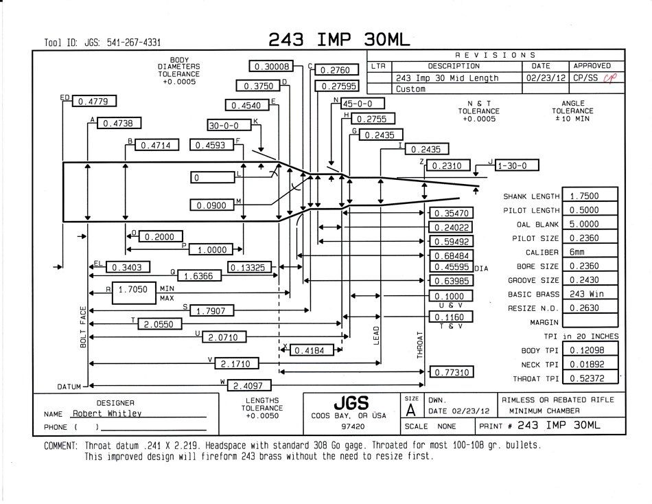

I just placed an order with Kiff for a new reamer to use for next season's barrel. I've attached the .xls file of the print that Kiff sent me (with permission to post).
It's got the longer .104" freebore, since I'm using AICS mags (R700 action in an Eliseo RTS stock) which are a bit longer than the Tubb magazines that Joe had in mind when setting the length originally.
Also, the body is a bit wider at the case head (and the reference diameter .200" up from the bolt face) to work better with Lapua brass.
It looks like it'll be just the thing for my next barrel. (Not that there's anything wrong with the current one... I've had 100-9X strings at 600 with three different bullets, and a 10X with 115 Bergers) I'll make a bit better use of the magazine box, and will be able to use Lapua brass--weighing out the Winchester stuff is a bit tedious--and it's the difference (for my gun) of MV standard deviations of 20+ and mid single digits.
Earlier in this thread it was suggested I copied the 6CM with my 243 Imp 30Ëš, but now I see the new 6CM design posted above dimensionally morphing toward my 243 Imp 30Ëš- - - ::)
People are funny.
Robert
