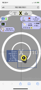

Here is some load development for my 6 BRA. Cases are 2 times fired with 108 Berger’s. Any help or thoughts appreciated 21ED681B-EA12-4E9D-ACE1-8C0063B8F647.jpeg
Would recommend you test in smaller powder increments. .2 vs .3 grains and extend the distance if you can. With that said, the 108s seem to shoot very well in the high 2800-low 2900 fps range.
Rich
Did this test by Eric Cortina’s method. New gun,new method....
When you get down to a close .1 then refine it a bit. I load to the second decimal (.00) instead of just to tenths. Some go to .000 if they have the equipment.
If you are using a long extruded powder, and a dispenser or scale that only reads down to tenths of a grain, you can get close by going up to the next tenth then removing a few grains with tweezers.
Ex. If you want 30.48, weigh out 30.5 grains then remove grains 2 at a time until you get to 30.4. Subtract the difference to determine how many are in a tenth of a grain and you will be reasonably close. More accurate than 10ths in any case.
I have a fax-120 AutoTrickler setup. I’m going to try again with 30.90- 31.80 in .15 increments at .020 jump.. to be continued
