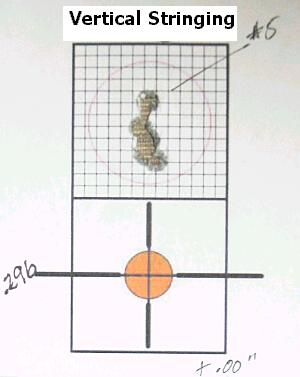

I just finished my first 6BR. 30" Krieger 1-8 HV barrel MBR tracker stock. Shot 8 five shot groups at 500yrds. The agg for the 8 groups was 2.505, the best 1.5" and the worst 3". I was very pleased especially since I have very little experience with this type of shooting. What I'm seeing is near perfect vertical string in each group. I'm shooting 107 MK with charges of varget from 29.8 to 30.2. It seems to be right on the edge of the sweet spot so i'm not sure if I should work with seating depth , neck tension, or powder charge to correct the vertical.. Also these results were with never fired Lapua brass. Any suggestions appreciated.

I have spoke with several very successfull competitors and the concensus is the same as what has been said here. Reload the once fired brass and shoot again. After that increase powder charge until the vertical goes away. I'm at 30.2g of varget behind 107 MK. I will try bump that .2 steps until vertical goes away or pressure signs.
If this persist during the next loading and EX spread of the velocities is not large, play with the parallax adjustment on your scope to be sure it is not parallax. Parallax is usually not in a single direction, but I have seen it this way before.
It would help to know if there is an order to the shots.
Also, it sounds like almost no wind. Was there mirage in a boil?
i think one thing we need to know is how much vertical are you having. A 1.5" group at 500 yards is pretty solid!! Can you show us? Lee

Thanks for all the replies. I will be shooting again in a couple of days. I will load the same load for the bulk of the shoot and take 15 rounds with a little higher powder charge to see what happens. I have just started building rifles and really didn't know what to expect from a 6Br as my others have been 308s. Where I live no one shoots these kind of rifles or matches so I'm feeling my way through on my own. Thanks again, I will post the results from the second round.
Great grouping - don't sweat it.
As everyone said (including yourself) try again with fireformed brass but also try and look at your velocities if you want to improve (hard to from there). A spread of around 40 fps for the 6BR will give you that much vertical on velocity alone ( around 2 inches+). Reducing ES can be never ending but some of the most important things are
1) seating depth and neck tension.
2) Accurate powder charges
3) Primer/powder combinations
4) weight sorted brass (and fireformed)
beyond that you need to start getting into neck turning, bullet sorting, annealing, flash hole and primer pocket uniforming, etc etc etc (many etc's).
Vertical can also be vibration nodes (tend to act more in the vertical) and bedding (have seen diagonal vertical but depends on where problem is) and others but I will bet it is mainly due to ES. 500 yards is starting to get out there.
Got out to the range Monday. I bumped the powder .2 to 30.2 and shot 13 five shot groups. The vertical is pretty much gone as the groups were clusters instead of strings. Agg for the groups was 2.375 best was 1.375 worst 3.125. I'm just gonna a practice for while and see if i can catch up with the rifle. Thanks for the replies.

There are many factors that can cause vertical stringing -- velocity delta being just one. As others have noticed, your results are pretty darn good already. Make sure the gun is placed in the same position on the rests every time -- a difference in bag placement can shift Point of Impact. Mirage can cause shift in true point of aim. Also read this article by Speedy -- it covers many factors:
Cures for Vertical Stringing
http://www.6mmbr.com/verticaltips.html
