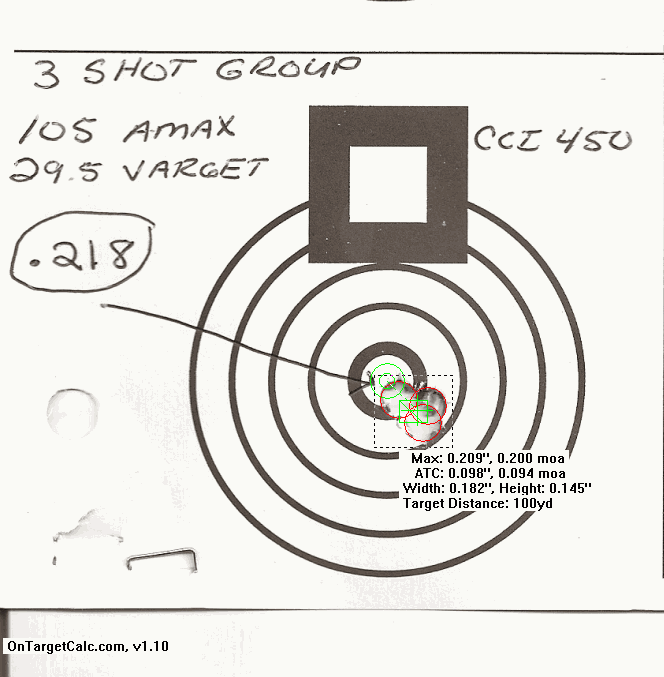

MEASURED-,.218)

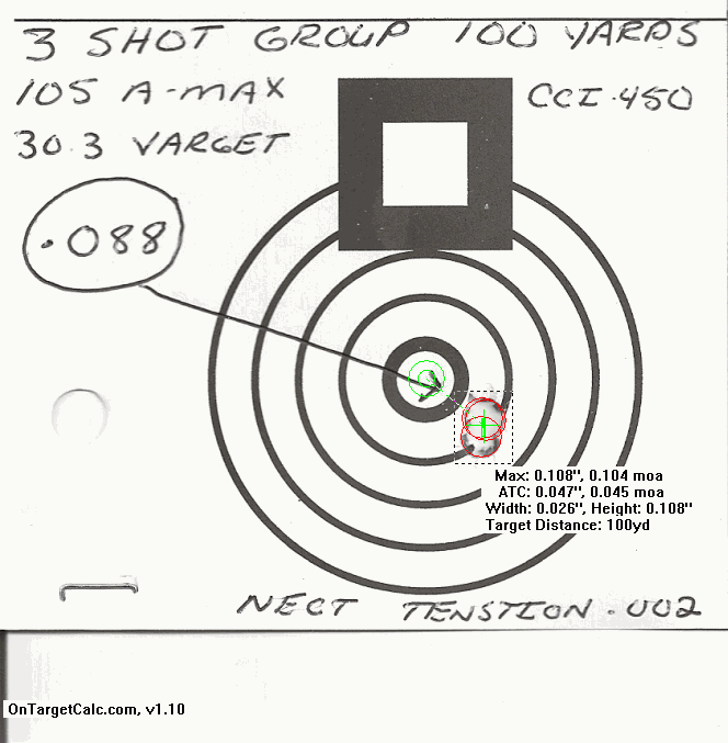

MEASURED-,.088)

Here are some of the original Posters targets, measured with the OnTarget Program. Two show up very slightly larger than the manual measurement, but the last one actually measured SMALLER than the claimed .218.
Anyway you cut it... those are impressively small groups!
Thanks for posting the targets. What a cool program for measuring groups. I am pretty happy with the velocity and accuracy with 30.3grns of Varget. It looks like 29.5 to 30.3grns is the sweet spot, with the 105grn A-Max, in my rifle.
