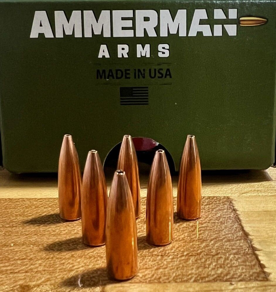

Ammerman makes good bullets. I'd try some 68s at those yardages. His bullets are cheaper than bergers. I feel your pain about the ranges in NY. It sucks.
