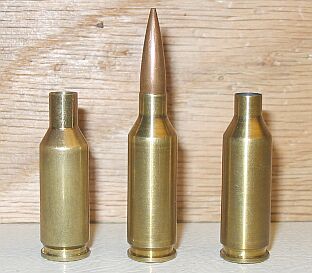

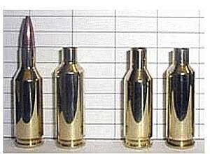

Dasher is a 40-degree shoulder, shorter neck. There are many slightly different variants. They all work pretty well. The BRDX has nearly a full neck, but 40-deg shoulder and less body taper.
I suggest you go with a Dasher or BRX. Dasher dies are available now from Redding. For the BRX you use 6BR seater and neck-sizing dies. A custom die is a good option for FL sizing the entire case, but some guys get away with using a .243 Win Body die to size their cases.
check this page: http://www.6mmbr.com/6BRImproved01.html
6BR Improved is a very nice way to fly. Gets you to 3050 fps very efficiently with the 105s, where they like to run. It is extremely accurate--all the way to 1000.
DASHER:
BRX,30 degree shoulder, uses 6BR dies):
