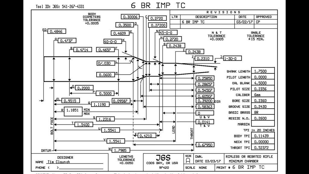

Here is a copy of what I am ordering. I changed letterbox T to a chamber OAL of 1.540" max and trim to of 1.530" just from something I prefer, a little shorter neck to balance out such a fine round. I wanted a flexible reamer, so zero freebore, and I have a JGS throater to suit 55 grain on up. .272" ND allows a light clean up pass on the neck turner, or will run as a no turn. I have been using a shortened Harrells D2 with no ill effects, thanks to an education on Harrells dies from a super duper nice fellow Mr. Stan Taylor. Works great.

Tclauch- thanks for print, will compare it to the Manson print. Appreciate the response to the question.
