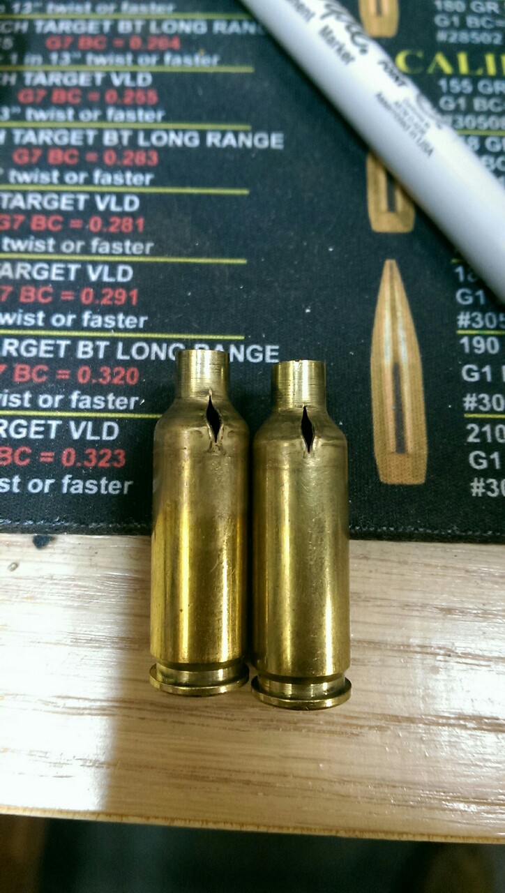

Lapua didn't help when they went from gold box to blue box and reducing the necks and case wall thickness down.
As you can see, the inside fold creases on this brass, it just another weak point. The new and old brass will always burst in the crease fold when forming out.
See the creases in this picture. All new brass has an inside crease folds when it is folded in to make the shoulder.
Wow, I wonder how much brass was removed on those turns. Good cautionary though.
I supplied the brass in the pics to DJ. It is blue box lapua and HAS NOT been turned. I have a fire-form barrel chambered with the same reamer as my match barrel and this brass was formed using the false shoulder method. My chamber is a .271 no turn that was designed around the blue box's thinner neck. I necked up with a 6.5 expander mandrel, then ran the brass thru my Redding Comp neck die with a proper bushing to form the false shoulder at the point where my bolt closed with slight efffort. They were loaded with a moderate charge and 70 grain Noslers for fireforming. The formed brass was then annealed and fired once in a match using 32.7 grains of Varget, 105 Hybrid and CCI450. They were annealed again and loaded for another match. It was at the third loading the splits showed up. It was not in every case from the box of brass but obviously they split where the old neck-shoulder junction of the original 6BR brass.
I shot that brass again this past Saturday without any further cases showing the signs of splitting.
Over the years I have formed a lot of Lapua 6BR into 6 Dasher. Until now, I have never had an issue.
I turn my brass like Donovan but I stop a hair short of the shoulder. I have done thousands and never had a problem. In the pictures it looks like they still are not formed all the way. That is the way my brass looks after fireforming. By the time they have 3 firings they are a lot sharper at the shoulder then those in the picture look like. Maybe not annealed enough. Matt

Cut the split ones with a tubing cutter and I find they all split on the inside in the shoulder fold.
It is quite evident that we are not getting what we pay for in quality from Lapua. Extractor grooves are not consistent and neck/shoulder thickness is not consistent.
Attached is a picture of the folds that showed up on the outside. Seems pathetic for what we now pay for them. Again, they are making it thinner for a reason and quality has gone down accordingly. They were designed to be 6BR standards not stretched to Dasher or BRX without having some shoulder failures.

some flaws with the Lapua brass are not as obvious. Some you need to take a closer examination. I cull out 2% - 3% of my Lapua 6br brass before even sizing up for 30br brass. When hydro forming dasher brass, it goes up to 6%-7%.
5d99096039ef68562eb791e59d55307a
I see the same thing as Wes. I have had up to 8 pieces out of a box blow out on me or have the fold in them and then the next box, same lot number, all 100 will form perfectly. Some of the cases with the line that just looks like someone cut it, go ahead and form just fine and some blow out with the first hit.
The ones that I have had blow out on me have always been on the first hit which is a pretty light hit. I have never had on make it to a second hit.
I sure haven't experienced that many failures while forming dasher brass... Must be lucky. I have formed over 800 Dasher casings (all recent blue box) using the false shoulder method and a stout load of Varget. Lost 2 cases in the process.
When I see the fold mark I pitch them. I usually get one or two per box. They always blow through and it is not good for your chamber when that happens. Matt
