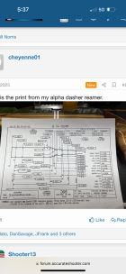

I want more free bore than that especially if 109 Bergers might be on your short list. .130"-.150". If you're never going to shoot anything heavier than 105's the .105" free bore will work but I'd still prefer more. But a lot of guys shoot .104" and are happy with it.
I can't exactly remember now BUT I had 4 or 5 Dashers and 6.5 x 47s each. I would say the Dasher is "generally" a bit more "consistently" accurate. I have had SUPERBLY accurate rifles in BOTH cartridges. I am not trying to brag BUT I will tell you the most accurate group I had with each. At 600 yards ONE time I was testing primers. It was an 8.5 twist 6.5 x 47, shooting Berger 130 VLDs using RL-15. I can't remember which primer or the exact charge but I THINK it was CCI-BR4s and 36+/- grs of RL-15. I shot a 5 shot group that measure right at 5/8ths of an inch. The Dasher was a Berger 105 VLD and 33.0Grs of VV N540. I can't remember the primer. But I shot a 5 shot group at 1000 yards that was just a "smidgen" over 2.5 inches. It also was a "one time" event. Conclusion: Get either>>>there is no way to go wrong!
How would you rate say.115 free bore
