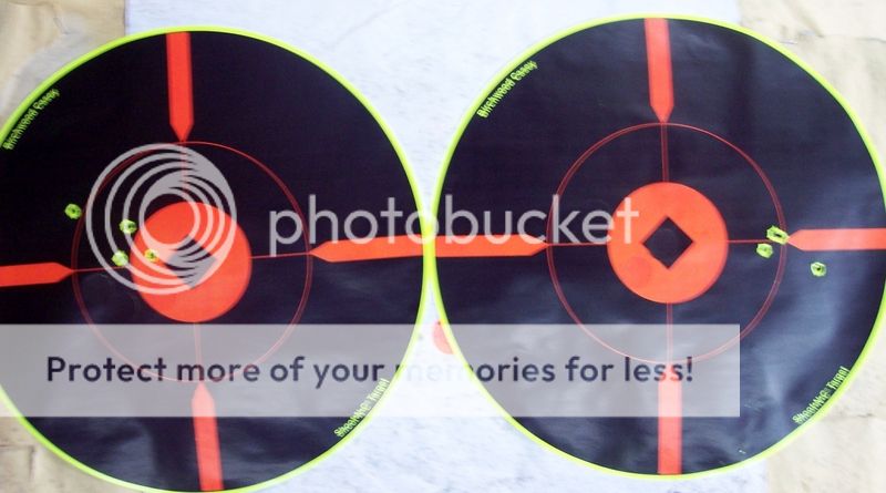

6 BRDX targets from today
no wind and very little mirage,,shot 2 4 shot groups that were 1.97 and 2.19 at 600 yards,with 32.2 RL15 .020 off a kiss ,this barrel seems to like it slow and easy,,which should leave room to bump up a little in cold and maybe not be as hard on barrel,
I took 20 rounds and shot 2 warm ups and 8 at 600 then dialed up to 26 moa elevation and missed first 2 shots left and then hit the 10 inch gong at 1,000 7 times in a row and missed last shot right,,all 10 were really level at 1,000,,I believe I will just load and shoot this combo a couple weeks and see how it holds up,,
my goals are 2 5 shot groups back to back at 600 under 2 inches,,
not as good as most of yall but I am still learning about this long range BR stuff,,
my rifle is a Stiller Tac 30 action with Jewell trigger at under 2 ounces that I bedded into a ST1000F with a Brux 8 twist taper to 1.100 at 28 inches chambered in the BRDX by Tim Claunch with a Sightron 8-32 SIII , I shoot off a Farley rest and Protector Dr flattop rear bag off a concrete bench
I load with Redding type s fl die with .265 bushing and turn my necks just slightly and run .002 tension,,CCI450 primers and seat with Forester Ultra Micro seater,,
I think I just need more practice and maybe a little stronger scope but anymore pointers would be welcome,,

no flags but mirage and grass was pretty steady left to right and I put in a click or two too much left and just shot for group trying to shoot only when mirage looked the same,,
I started with jam and seemed to get a wild flier 5-6 inches out until I got back off the lands,,not counting the wild shots it grouped better about .015 in lands but it seems more consistent off the lands,,
think I will try 108s and maybe invest in whidden pointing dies,,

shot these two targets today at 32.0 even and got 2.29 first 4 and made one click right and shot 4 at 1.485 in a pretty tough 11 oclock headwind
I did run out of 4350 I had and this lot may be more like 4831 but I cant get anywhere close to 3,000 or groups I was getting with other lot and Kreiger bbl..but I think this bbl shoots better with RL15 than other bbl did with 4350.
from today
Targets look good! Kick it up to 5 shot groups and you will get more of a idea where you are at.
Keep up the good work!
Those last 2 targets look like the first firing on freshly annealed cases. The top 2 look like maybe the 2nd or 3rd firing on the cases without the torch. Just a guess, and nudge. ;)
