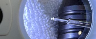

This is the pics of the bolt before I tore it apart. There was a pierced primer at 31.4. I have no idea as to how I missed it as I was singularly checking each case for pressure signs.
I'd be a little bit concerned about the fp hole. It might be ok but it appears to be kinda hex shaped and possibly bushed already but that parts hard to say for sure, but it looks that way and that whoever did the work likely did the fp hole at the same time. It may be why you had a pierced primer and a pierced primer might be why it looks out of round too, as the escaping gasses might have burned the fp hole out of round and oversize, which compounds the pierced primer issue. The same escaping gasses can etch the fp tip, again compounding the problem. I think I'd have it looked at by a competent smith but don't continue shooting if it pierces primers as it'll only get worse. Put a fresh spring in it and address the fp hole issue for starters. They'll fix the pin tip at the same time, or should.
A temporary fix might be a harder/thicker primer like cci 450's. It may well stop the piercing for the time being. You may or may not need to re-tune but starting over and working back up is the default answer there.

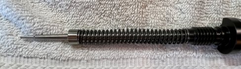

I’ll take some better pics of the bolt, including firing pin assembly & post if you’ll look at them. If there’s something wrong with the bolt I’m sure it would be a result of the pierced primer. I had this action on another rifle previously & it’s always performed great.
The primers are already 450s. I have an “old” box of 450s that I use on the 1st 100 rounds I fire out of a new barrel. If I have lower quality bullets I usually use them on the 1st 100 rds also. On this one I started with the bullets I hope to use through the life of the barrel.
I and likely others will be happy to look at other pics. This is the pic that concerns me. You can see, that hole doesn't look nice and round any more.
Here’s some more pics. If there’s something else you would like to see I can get it….thanks
The .072- pin wouldn’t go in. This is the .071- pin that is in it.
