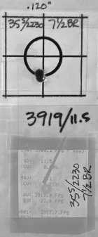

Sako action, Hart 14tw. They feed as a repeater, Would be just dandy on coyotes. 3 shot groups.
