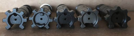

I made these from 2007 until 2017, they were strong enough to run a 6mmBRX at 65000psi for 10 years. Like someone above said the grendel guys don't like me much LOL. I told them in 2006 the bolt was a problem and the mags were problems but instead of acknowledging those problems and working on a fix they just said the bolts don't break and the mags feed fine so here we are 16 years later and the same problems still exist.
Standard 5.56 on the left, 6.8 Superbolt, Titan (7.62x39/Grendel), 750XD(308 diameter and the 800 series(308 diameter discontinued in 2015).
Are they the ones on the right? I remember those and yes, they were a lot stronger. They had a radius between the lugs, as those appear to have. Are you still making any of those and the bbl extensions? From what I recall, they were the best and it's easy to see why.
The 800 series on the right were the first ones I made starting 2007. In 2015 Kramer tried to sue me and rather than paying an attorney $500 an hour to prove his patent invalid I just redesigned the bolt to the 750XD, second from the right. I had to redesign again so it would work with the 6mm and 224 Predator cartridges, the thinner lugs/grooves in the barrel extension guided the bullets higher so they entered the chamber instead of slamming into the breech. In 2017 I semi-retired and stopped machining all of the bolts.
Thanks! Good looking design!
