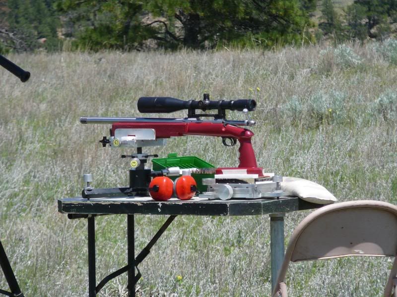

I shot a modified,rear grip)Savage Striker this last season at our club.
I understand the quality of equipment and shooters at all the Matchs around the country.Our club, Colorado Rifle Club ) has its share of accomplish Marksmen... But a Guy has to set GOALS...LOL
Here' my son n law,Kevin)first time behind that Striker..
a 6mm Rem, 7 twist for 115's.
Although it shot good ..> 3/4' at 200 yds most days,trigger and balance,tracking) was a on going problem . so I decided to build a New gun for the up coming season,and see what happens.Wish me Luck...LOL

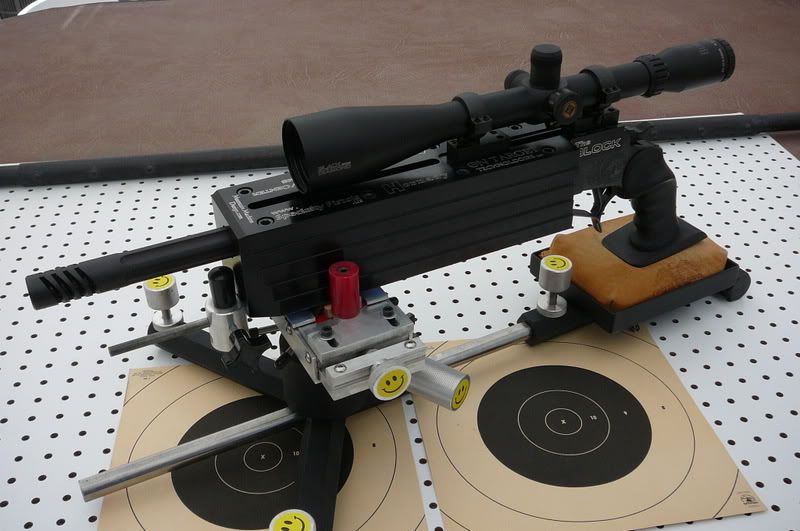

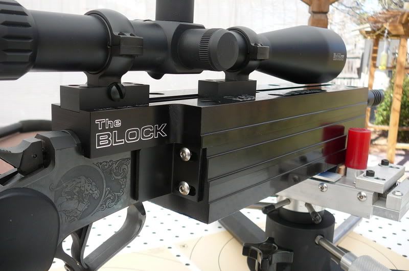

Here's a Barrel Blocked Contender I built for 1000yd Prairie Dogs .a 5.6x50R Imp, shooting 80 gr bullets.weight 16 #, worked good ...1046 yds so far .
This has been taken apart now, and being fitted to a Encore Pistol, a 18' 280AI, for the 162/168 gr bullets ..another 600 / 1000yd effort .
Ray
Very nice. Not quite what I had in mind but something to consider. To be honest I'm not sure what I have in mind.
What kind of accuracy do you get out at 1000 yards with it?

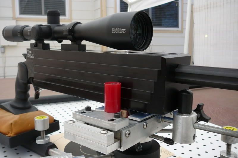

Ray, who built your various rests and tops both the ajustable to length one piece and two piece units look very well thought out.
Regards
RJ
RJ ...
The rests are built by a good friend of mine...Cayle Davis
C & J Machine
Palmer ,Ill.
xpfuzz@consolidated.net
Hope this helps ... These are a Great Product .
