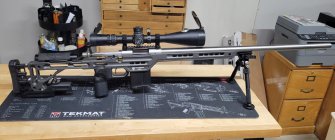

So its here.... pic below.
Specs:
  • Trued Rem 700 action that was a 6.5 CM I wasn't shooting alot, tho it was a 0.3 - 0.5 moa gun. Been wanting to get into 6mm
  • 28" straight taper Douglas 7-twist barrell @Stan Taylor hooked me up. Quick turn too.
  • Timney trigger. Can't remember pull weight prolly "heavy" ( 8oz) the way I like
  • MPA chassis
  • NSX 8 - 32 NF
  • Lapua brass chamber
Mostly a range toy but wanted to leave myself room for F-class comps in the future. Intending 600 - 1000yd shooting, 105 - 108 gr bullets. Maybe some 300 yd. Not less than that, though

THanx.View attachment 1283891
