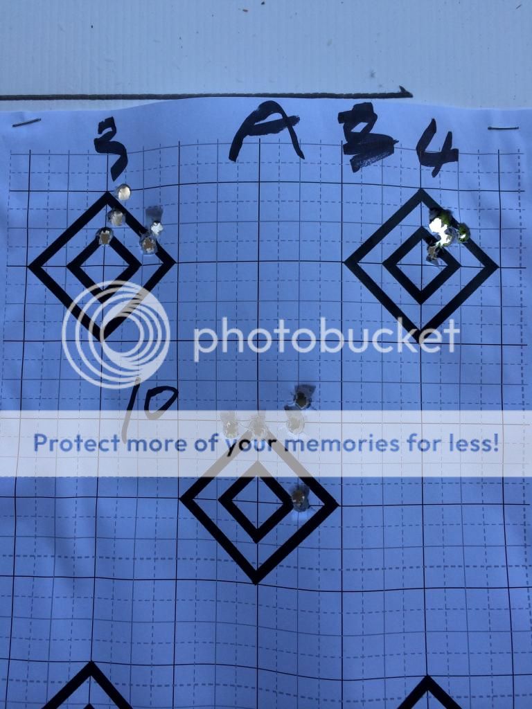

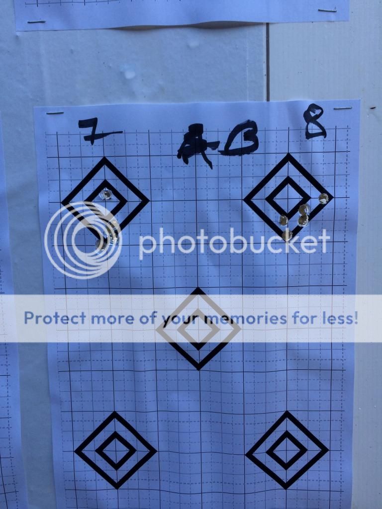

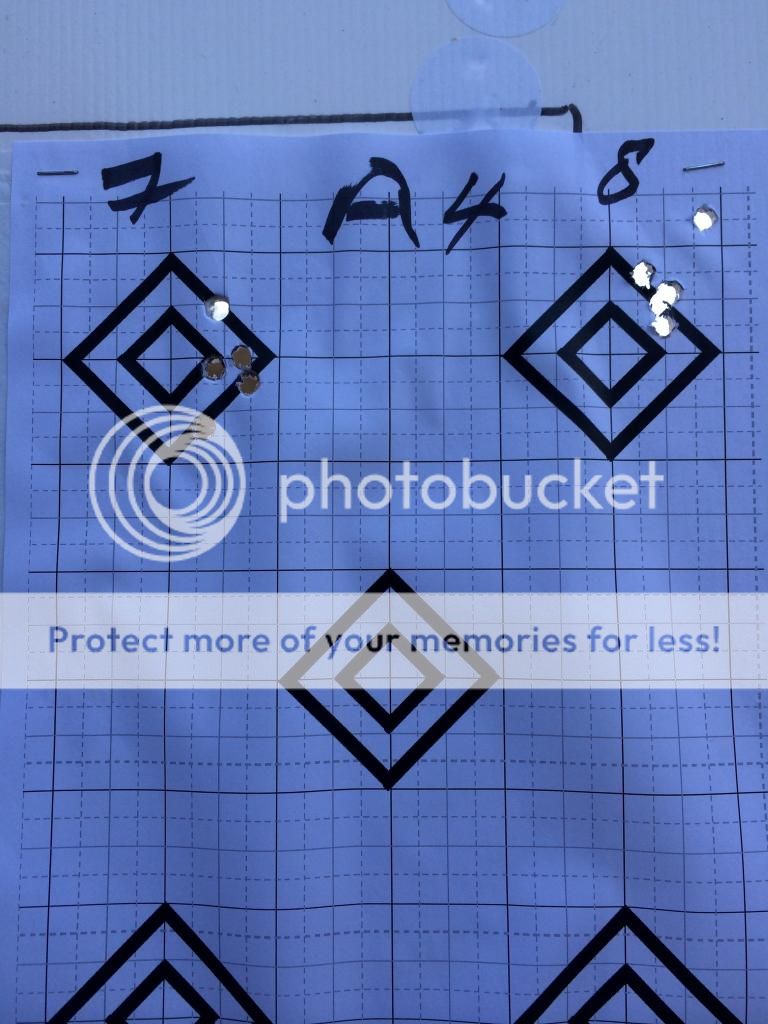

Craig,
Managed to get a few rounds off at Bisley today, blowing a gale and pissing down. Not the best weather for LD!
So shot 100 rounds of 120g Amax in 5 shot groups with differing loads of N140.
I borrowed a mates chrono which wasn't that happy in the rain!
I won't post them all up or I will be here all night.
A4 34.5gains 2704/2716/2719/2689/2690 spread 30
A8 36.5grains 2804/2826/2839/2781/2779 spread (60) flyer down to me
B7 36grains no chrono flyer down to me again
B9 37grains no chroni
Not sure if there are any useful conclusions here.
Gonna try 140 Amax next followed by 130 Bergers and buy a decent chrono.
