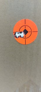

Well fire forming brass today and 39.5gr of n550 got me to 2790fps with 140s and 26" barrel. No pressure went up to 40.6 gr still no pressure at 2840fps. Node at 39.5gr.
