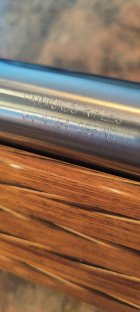

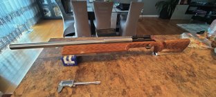

Hi everyone I'm new to the channel and new to the 6.5-.284. I recently bought a heavy gun chamber in 6.5-284 with the .285 neck. My question is would that be normal for thatIMG_20210823_162943.jpg
caliber to have such a tight neck? Or should I get that chamber opened up. IMG_20210823_162334.jpg
