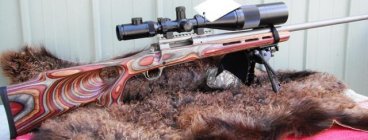

:) I use a Ruger VT 28" barrel for Long Range Goat hunting, using Berger 140 gr VDL Hunting Bullets with Fed 210 M primers, Hornady cases, .287" neck bush and AR 2209 [your equivalent H4350] 42.5 gr @ 2805 FPS OACL=2.888" for .050" off the lands.
I have been using this combination for about 3 years and have never had an issue with it. I find it extremely accurate I have it topped with a 8-32x56 BR Nightforce Scope. The modification I have made include a Rifle Basix Trigger, bed and floated the action and barrel and fitted it in a Boyd Thumbhole Stock. I all so prep all my brass.
Never had any problems with the Hornady brass and some would be on there 8th fireing, but I do anneal every 4th firing.
Hope this answers your question!!
shanghi

Thanks. nice rifle shanghi.
