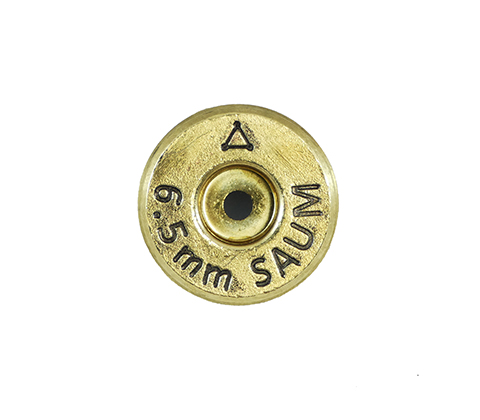

ADG makes 6.5 and 7mm SAUM head stamped brass. If you aren't familiar with ADG they make very good quality brass. Last week Precision Reloading had 6.5 SAUM brass in stock but I think I got the last box they had because it showed out of stock after I placed my order. It also comes up for sale in the classifieds on this forum and others like it.
I just looked and it shows ADG having six boxes of 6.5 SAUM brass in stock right now so if you want some I'd nab it now cause it won't last long.

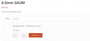

They still have 3 boxes left as of a few minutes ago:
J/A Outdoors has it listed as being 'In Stock':
https://jaoutdoors.com/product/6-5-saum/
