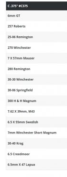

If you don't have the SAMMI specs...
Hornady states: “To determine the proper bushing diameter for your cartridge case, simply add the neck diameter and the shoulder diameter and divide that number by two. Use the bushing closest to that number.” Hornady offers five: .330″, .350″, .375″, .400″, and .420″.

Where did you come up with that chart. I`m looking at the back of the package that my comp gauges came in, not a one of them say 6.5 Creedmoor on it. Especially the C.375 package. Seems the 6mm Creedmoor isn`t on your list here, and it seems it should be, since its the same cartridge as the 6.5CM, just a smaller neck size in the 6mmCM.
That's why it's not on there. Same cartridge. Also that is on the Hornady site. I thought I linked it earlier.
Use the D .400 for the Creedmoors. It's the one I was told to use by the guy who created the round and I have used it since the round came out. On the Hornady site it says the .375 so you could probably use that also as it's just a reference point.
I did. There is the link.
