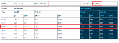

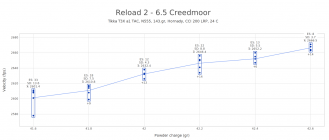

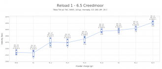

I have found some N555 powder and Hornady 143 ELD-X bullets. I would like from you guys to give me an opinion on two charts.
I don't have any pressure signs, using once fired Hornady brass, FL sized, trimmed and expanded to .263 with expanding mandrel, primers are CCI 200 LRP. Would you go higher with a powder charge?
Thank you!

What barrel length? Did you note any POI shifts in these shots?
@antunRC: Nice rifle. I have had a few just like it. I mostly shot the Hornady 140 and 147 gr. ELD-M but my experience was that those projectiles are very similar to what you are using.
In both of my rifles, the barrels were a little slow. I understand that is common across Tikka barrels.
For 6.5 Creedmoor using the 140 grain class of Hornady bullets, you are going to find a great accuracy node around 2720 to 2750 FPS. That is with H4350 but you are using a powder very similar to that. You should also find a lower accuracy node around 2690 +/- 10 fps.
That said, 42.6 has a nice SD. What is the group size of that load? If that speed meets your requirements and the group size is small and repeatable, you probably have a winner. How many rounds has the barrel shot?
Lastly, what is the main purpose and nominal distance the rifle will be shooting? Guessing hunting by the projectile.
All of the disclaimers apply about working up to those speeds carefully and making sure it works in your rifle. You and you alone are responsible for the results of your hand loading & etc.

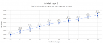

So after having a lot of problem with consistency and runout with my Hornady brass I have decided to buy some Lapua brass.
Here is my initial test with Lapua brass:
Bullet was seated to COAL 2.810 (2.066 CBTO) [per Vihtavuori I should seat my projectile to COAL 2.709]
Runout on seated projectile max 0.001" most of them where 0.0005"
I had a lot of struggle with my rear bag. I need to replace that fake sand with the regular one.
Honestly I'm still not happy. I was expecting higher velocity numbers. Usually I was shooting factory ammo (Hornady Precision Hunter 143. gr. ELD-X) and I had best group sizes 1/4 to 3/8" on 100m but now I'm struggling reloading the same projectile.
41.5 had best ES with 2573fps but 41.3 best group size. Any advice and suggestions more than welcome.

What profile is the barrel? How long between groups?
If you were struggling with the bag are you sure those groups are a good representation of what those charge levels can do?
Any pressure signs on lapua?
With that brass and +saami seating depth I would expect you could reach 2700 at least.
But I do think you have can find a good load between 2550 and 2590 fps. 5 Shots each to better nail down velocity range and a little seating depth testing and you're good. I assume hunting with an eldx bullet. Deer won't tell if the bullet is 100 fps slow at any distance you should be hunting with a 6.5 creed.
He's using small primer brass and CCI-BR4s - look at the load details on his attachment on post #6
I see it now in the first image. Upon further inspection though his ES numbers look tight enough that I doubt inconsistent ignition is a problem.
Quick response: I see that some very knowledgeable folks have weighed into this conversation and when time and workload permit, I will read rather than skim their posts.
Your 41.1 and 41.3 groups and SDs look good to great! The Tikka freebore is V E R Y long. If you are at or near magazine length you are likely jumping .09 or more.
I quickly read something about runout. One of your posts mentions .0005 of runout. I don't have a tool that can accurately measure that but I can tell you that .005 or five thousands of runout isn't going to negatively affect anything in that rifle. Tikka actions are good. The TAC A1 chassis is very comfortable but the action is not glued or even bedded in any way. Make sure it the action screws are torqued correctly and tight.
So, you are shooting great and have some great groups. That will be fine out to 1000 yards. More speed is is good if competing but I'd take the accuracy and good SDs within what looks like a reasonably wide powder charge over extra speed.
I have shot 5-shot groups with Berger 140 VLD-Hunting bullets at 100 yards in the .2s but that's it. Nominal group size was in the high .4s with Hornady 140 class bullets. Hits on steel out to as far as 1300 yards here in low altitude Georgia were reliable on 18" steel with good wind calls.
There are two suboptimal things about your Tikka if it is like mine and the others I am personally aware of. The barrel is slow. Seems common with Tikkas. The freebore is long. Not a big problem but you may want to load closer to the lands and that will often take you to the very edge of Tikka's very good proprietary magazine or just beyond it.
This is just opinion, of course, but you don't have a problem and nice shooting!

This is way more than what Vihtavuori shows on their website.

I also found Vhitavouri’s data not even close.
