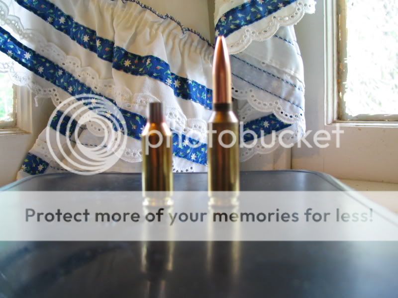

I have to admit that I'm really bored so I've been wildcatting. a couple of weeks ago I chambered a 30BRX. It's a 30Br that's blown out an extra .100". That cartridge is a real good shooter for 100/200 yard benchrest.
Last weeks project was a 6.5 BRX with the case being blown out .150". I tested it yesterday at the Denton range and was able to get 3100fps with a pretty hot load of RL15 and a 120gr Matchking. I suppose I'm trying to figure out if this is a useful cartridge. How much speed are you guys able to get with the 6.5X47. I like using the BR case as it will drop through the drop port on my Stiller actions. I have the Shilen 27", 8 twist barrel mounted on my Tinker Toy gun and am thinking about trying f-class as soon as I get good loads developed. I may want to run the chamber out to .175" long to make it work better with the 123 gr Scenars that I really want to use.
What do you think??? Is it worthwhile?
The photo is of a 6BR and the 6.5BRX.
Thanks
Shelley

With the 6.5x47, with the 123 Scenars, we're seeing realistic speeds from 2920 fps to 3050,max). Some have pushed it much higher than that in long barrels, but I don't know anyone who's shooting 3100 day in/day out. I know Darrell Jones ended up at 3000-3038 with 120 Cauterucios. He had tested at much higher levels, but the accuracy wasn't there.
The real question is how fast one can push the 130 Berger. Jason's working on that right now. It appears to be capable of speeds equivalent to the 123 Scenars, but Jason's initial testing, in a Krieger barrel showed best accuracy running sub-2900. We'll soon have a Bartlein 31 incher to play with and Jason can explore the upper node.

I extended the 6.5 BRX out to .175" longer than the 6BR and then throated it out as far as possible with just about .050" of a 120gr Sierra holding in the case neck. There's not a whole bunch of case neck left. I wanted to try it with a bit more combustion chamber. I suppose this would be a 6.5BRXX
Yesterday, with this configuration I could easily get 3100fps without losing the primer pocket. But the accuracy is really pretty good at around 3050fps and the case is in no danger of being wrecked. I get this with about 2 less grains of powder than it took to push a 6.5X47 120gr Sierra around 3000fps.,I didn't chronograph the bullets when that barrel was chambered in 6.5X47 so the 3000fps is a guess.) This round is good for me as it'll function in my Drop Port Diamondback and I'd have to do surgery on the actions to get the 6.5X47 to drop.

The 6.5 TKS is, more or less, a 6.5 BR given the Ackley treatment and throated for the 139gr-142gr bullets. Velocities you may have seen involved warm loads. I briefly shot a 6.5 Viking which has the shoulder move forward something in the neighborhood of 0.080" from the TKS,definitely not as much as a 6.5 BRX), but I was unable to get adequate velocity with the heavier bullet without going to VV #550 which is not a stable powder in the type of temperatures I shoot in. Apparently, the little extra case capacity did not help out and the throating could have been longer. It shot well though. All the variations on the BR case seem to have shot well.
