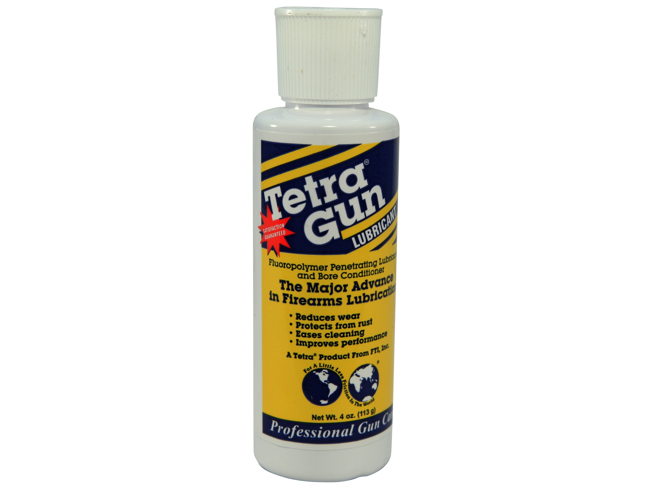

I decided to cheat, this stuff dripped on the pivot points work it and then dry it up lasts a real heavy session or two makes things work like butter, maybe one day I will upgrade to the lube zerks
www.midwayusa.com
Tetra Gun Lubricant Gun Oil 4oz Liquid
A great oil for actions, barrels and other surfaces subjected to friction. Features an operating range of -100 degrees F to 750 degrees F. It's applies...
