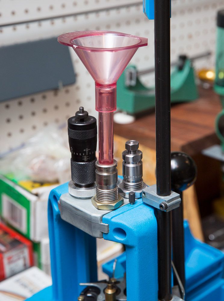

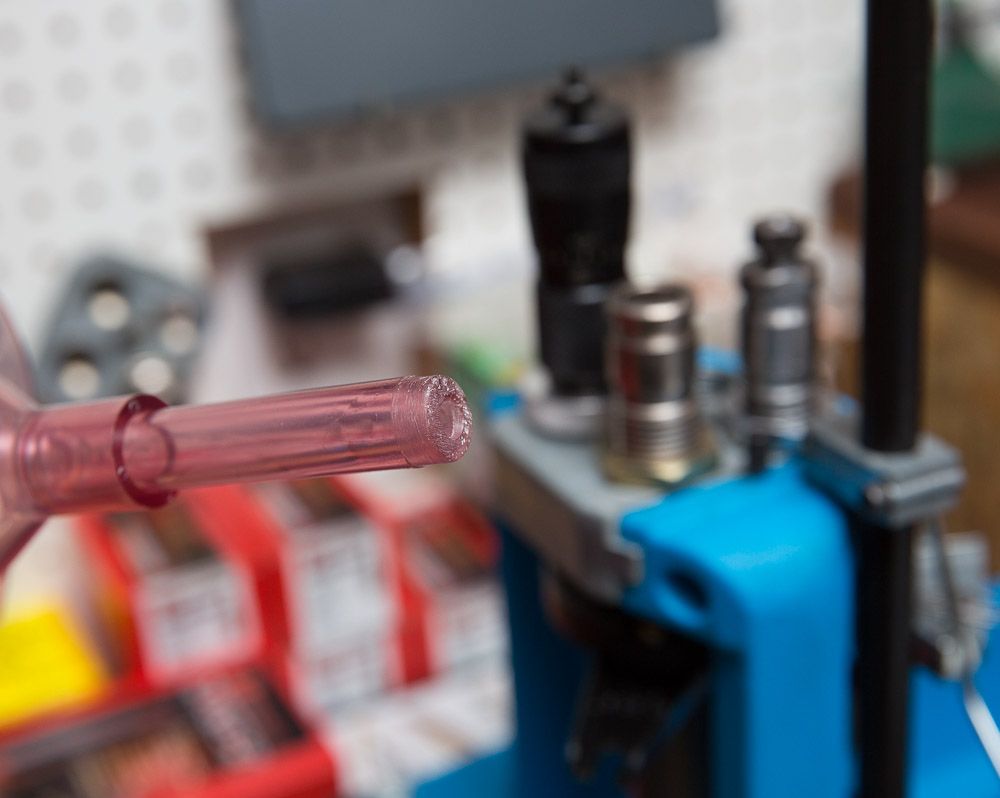

Here's some pics of what I use for a powder funnel for manual charges. It's the universal powder funnel and drop tube from the MTM powder funnel kit. I cut the base of the drop tube off at the point where the inner tube was the narrowest. Then I lightly sanded it for fit in the Dillon powder die, and used a bit of heat (torch) on the powder die to get a tight press fit of the drop tube. It sits at exactly the height the inner powder funnel comes up to, and since the drop tube ID is much narrower than the powder funnel no kernels can get caught on the lip of the inner Dillon powder funnel and hang up. Sits nice and stable when the ram is in the down position. Plus since it's clear you can see if there are any issues with bridging.
Took about 5-10 minutes to modify.

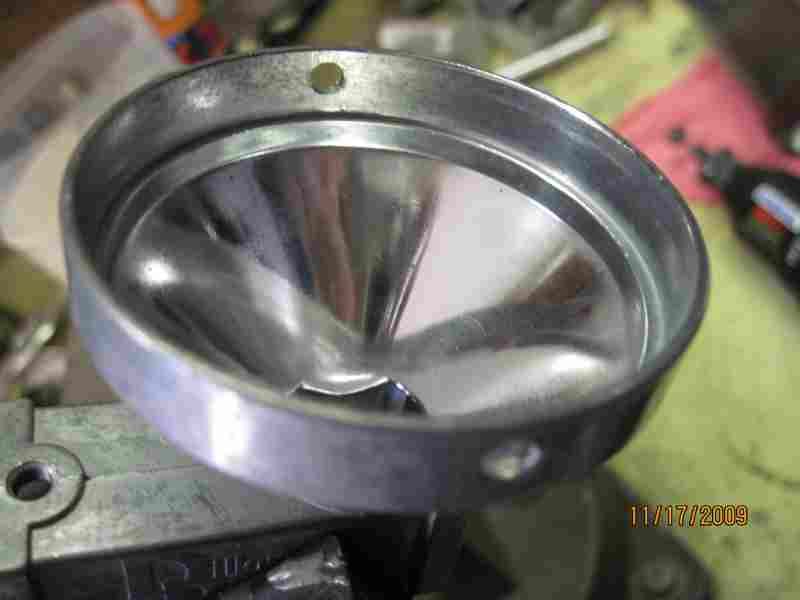

4. Disassemble your powder measure and polish the aluminum funnel to improve consistency of the flow and to reduce the chance for bridging. I'm including a picture to show level of polish to achieve.
[URL=http://s860.photobucket.com/user/jepp2/media/Dillon%20Powder%20Measure%20Polish_zps1hxxb2mz.jpg.html][/URL]
