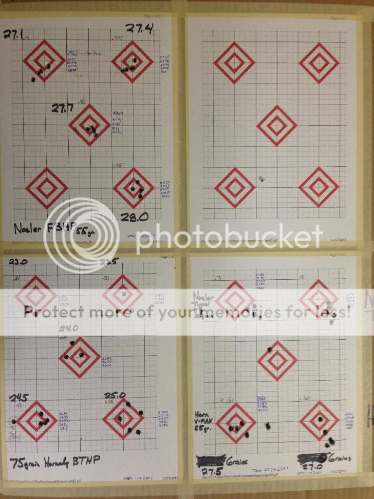

Is that really slow? It is near max powder charge listed. (I know all guns have different max loads my .308 175SMK is 46.0 of RL15) I am not too concerned about max velocities, just looking for an OK (.5MOA)load quickly. This is a bone stock Savage 11-vt, no nothing done to it nothing going to be. Just I would prefer a load to work out to 600 not just 350...,
I was happy with the stock $450 gun--test groups below

Troy, are those groups at 100 or 350? It looks like you need more tuning, either way.
Scott
