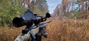

CVA Cascade XT Hillside camo 450bm 22" fluted barrel rifle with Bearcreekballistics.com ammo. Submoa rifle and ammo tested out to 300yds on SMT E targets. For bolt guns 240HV@2590fps, 200HV@ 2800fps. Cnc copper alloy bullet 100 wt retention. Mushrooms to .802 expansion 24" penetration in ballistic gel. BCB bullets expand/mushroom down to 1150fps- Hornady and Barnes only 1800fps. Five Illinois whitetails DRT, good blood trail, travelled 20yds. BCB articles in Illinois Shooter Newspaper last year and 2 articles Fall edition. Accuracy and performance. All one shot harvest. 200yd heart shot on one deer.
