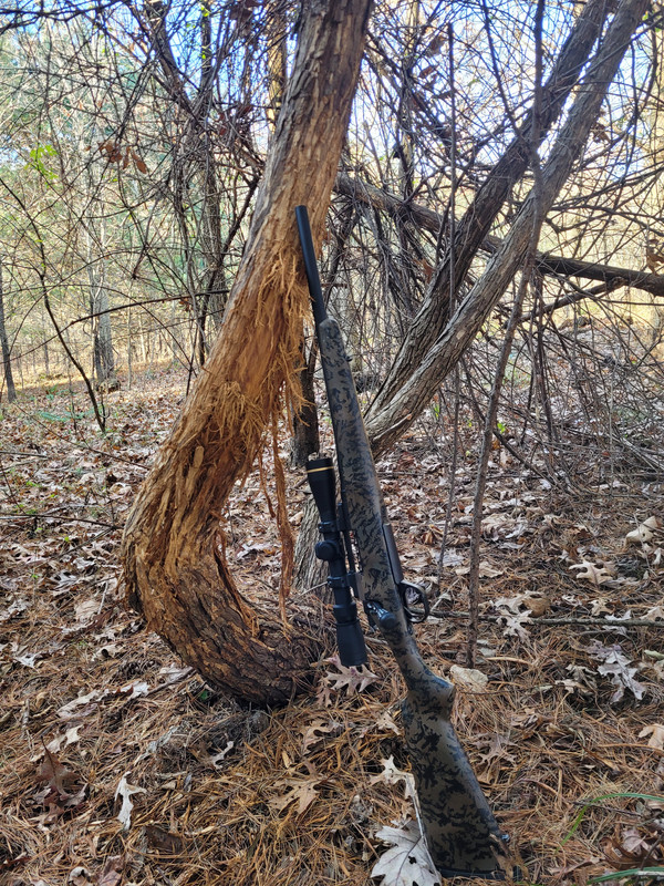

I built one on a m700 action I had laying around.
Got a smoking deal on a Browns Precision Pound'r and refinished it. Had McGowen spin me up a "Remage" barrel. Hardest part was getting the cooked m700 barrel off...whew. that was fun lol.
Like was said, you can get a good bit more velocity from bolt guns and handloading.
I'm running a 250gr TTSX at 2350 and it'll shoot silly groups for a rifle that's just over 6lbs.
One of my favorite hunting rifles.

That’s good to know! I talked to McGowen about a barrel last year, but I never pulled the trigger. Are you feeding from a magazine or single loading?
Feeds right out of the bdl box mag. I was pretty surprised it feeds and ejects with no issues at all.
That barrel looks thick but it's really not. It was basically as thin as they would go. I can send you the barrel specs if you're interested. I think I went with 18" and a pretty fast twist...I don't know that barrel length makes a ton of difference in that case....I do know from others have fojnd that fast twists build pressure and can hinder speed...I've went higher with my powder charge and never saw much difference in speed bjt never saw pressure...and being just over 6lbs, I don't really want any more recoil lol. It's not BAD. But I wouldn't want a lot more. A 250gr bullet at 2350fps is plenty for most anything.
I had the action with a dead barrel on it....otherwise I may not have done what I did. But, I love how it turned out and it's a killer...I was very surprised at how accurate it is.
The 250gr TTSX pushed 2100+ is absolutely awesome. I love the performance I've seen thus far.
That was after blowing through a buck and dropping him where he stood lol.

450 Bushmaster, 1-16" Twist, Stainless, REMAGE Threads,
McGowen #3 Contour (approximately .705" at muzzle), Recessed
Crown, 18" Long
I thought I had more specs but I don't. I called them and talked to them about it and wanting the lightest 450 bushmaster barrel they'd be able to do.
Hindsight, I'd have had them thread the muzzle....a suppressed subsonic 450 bushmaster would be plain ole fun....and unfortunately, I don't think there's enough meat left to do it now. I'd had loved to have that option available.
