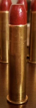

I didn't have to shoot to 200 yards, so I only loaded some 500gr RNFP Hard Cast over a light 5744 charge for use during deer season. I use RCBS dies and a Lee Universal expander.
