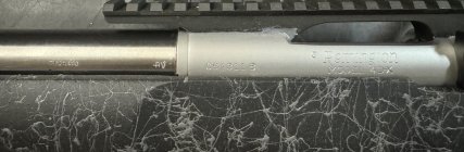

I know that it a stripper clip repeater, but what is it? The barrel has the Remington roll stamp with address and 308 caliber. It has no proof marks or the number code to date it.
I have looked at most of my Remington and Custom Shop barrels and I don’t see any that lack proof marks. Only one of them, out of the custom shop lacks a date code.
None of my repeaters have that “U. S.” engraving over the serial number. The roll stamp on the barrel with an address is completely novel to me for a 40-X. I don’t have any that are either roll stamped, or include the address.
Ok, that barrel is similar to the one I have that lacks the date stamp on a custom shop 40X, late 90’s. Mine was definitely engraved and had the typical cone contour. But the serial number of the action puts it in area of the 1970’s.
My stripper clip repeaters are in the 60k serial number range and still look old. Your action markings do not look old to me. The 40-X looks different in fact, a bit compressed lengthwise and smaller X. The Action apart from the US actually looks like the RR era.
Something is odd. Your gun looks cerakoated and I’m wondering what the appearance was at that time. I imagine that these stripper clip guns were thought to be usable by the military but none of mine say US. That US mark does not look to be a later added addition.
Possibly the rifle is something provided in low quantity in the Vietnam era for sniper use or training.
The US is centered over the serial number, so that looks legitimate.
