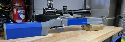

Hi I'm Jim Nicolas the guy at Seymour last year. I have been developing 3D printed rifle stocks for a couple years now. The orange Heavy Varmint (HV) on the left was my first functional prototype, the red one on the right is the a Light Varmint (LV). The HV shoot lights out and I won at VFS at ASC three of four times last year with a 30BR barrel on it.
I didn't have much luck at Seymour match last year, but I did manage a small group in one of the matches. I only practiced once with it and then the match. Unfortunately I have not shot anything since due to medical issues.
The black stock below is an ultra light stock weighing 17.9 oz painted. This allows the shooter to have BAT-DS action (or other), 15-55 variable night force scope, and still make the LV weight limit (10.5lb).
The rifles are made of engineering grade carbon fiber material using a high temperature, enclosed 3D printer. A vibration reduction system is integrated into the stocks to dampen higher order modes which significantly improves tracking for LV rifles.
