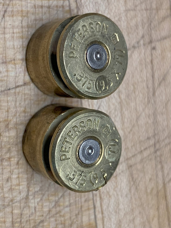

Hello Kimber .204 - my process is close to number 1, accept cleaning, length trimming before annealing f.e. - Until now I was very happy with the service, we had also good experience at the IWA in nueremberg, I´am only dissapointed with asking questions from peterson and then never heard anything else again.

So you fired the brass once in this same gun (I'm assuming).
Then you cleaned it and trimmed it. I'm assuming that you sized it before you trimmed it.
I haven't loaded for 375 Cheytac, but I don't typically need to trim after the first firing, especially with Peterson brass. Was this done just for consistency, or was the brass out of spec (too long)?
If the brass was so long that it NEEDED to be trimmed I would think excessive headspace is the problem.
If the brass didn't really grow after the first firing (I don't know why you trimmed it) I might suspect the brass itself.
The other thing you mentioned was two different bullets. I'm familiar with Cutting Edge, but not the other bullet you mentioned. I've heard of guys having pressure issues switching between solid and traditional bullets, but I've never experienced it myself.
Also, I would just send a few pieces of the new lot back to Peterson and ask them to test the brass, check the dimensions, wall thickness, case head hardness etc. I know and have shot with the Lead Ballistician at Peterson, and they run a pretty tight ship. But like anything, your product can only be as good as the materials you put into it.
I think you said the only things different were bullet brands and brass lots - have you tried both bullets/loads in the "good" lot of brass?
Good Luck, keep us posted.

Hello Shaun, just to finish the session. It is not the knowledge of reloading, it is the behavior of petereson to start a discussion, and then never answer again. If it is headspace and could be prevent, why other brass is working fine? - Thanks for your advice!
It sounds like the Peterson help line triaged you into the nothing to see here can't be helped bin. We only have one side of the conversation so it's tough to take sides.
On the why, we don't have any actual dimensions from you, specifically the bump for each case you've given so one of the subtexts in this thread is the assumption it wasn't measured. I'm sure many of us are struggling with the idea that the bump for the last lot of brass when new, as fired, sized, the new brass as received, fired, and sized after annealing are the same? Actual load, gun, and velocity data might also yield more focused suggestions. What was your annealing process? You might not like all the answers, but there will be things for you to check next time.
The flip side to your question is why haven't there been report of similar problems with that lot of brass?
I was given these as a trophy at a URSA match by the shooter that produced them.
Experienced reloaders won't blame the brass. 3 firings if it's not obvious. This is why I suggested checking pressure.
