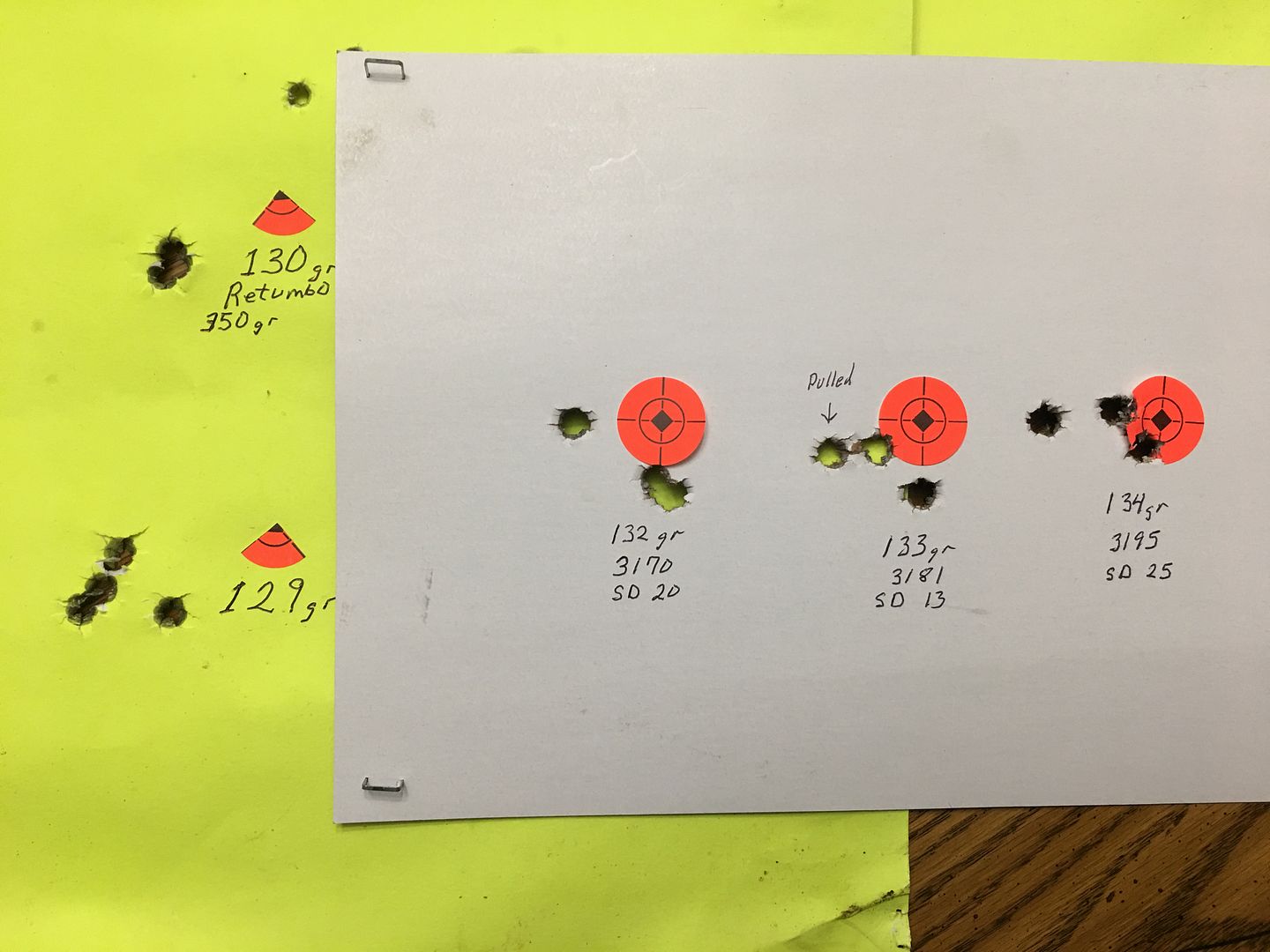

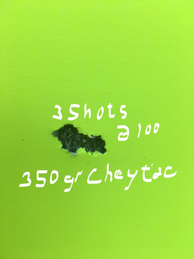

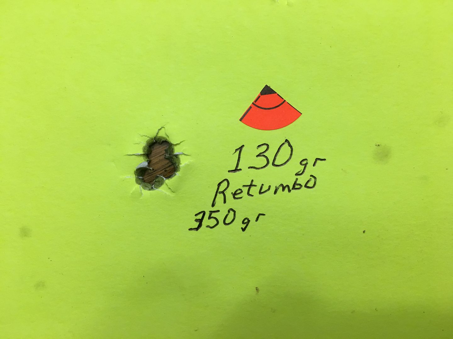

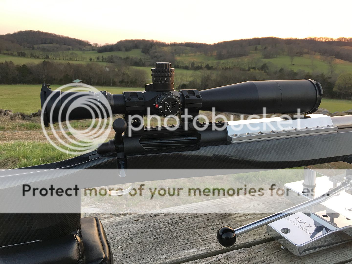

I have not found the proper bullet depth setting for the cutting edge 377 gr with the pressure ring. But, I started out with the 350 gr Cheytac brand bullet and have stuck with it. Best accuracy at 100 yards is with 130 gr of Retumbo, 3095 fps. 35 inch, 10 twist Bartlein. I can most of the time get 2 of 3 shots touching, sometimes all three touching at 100 with this load.

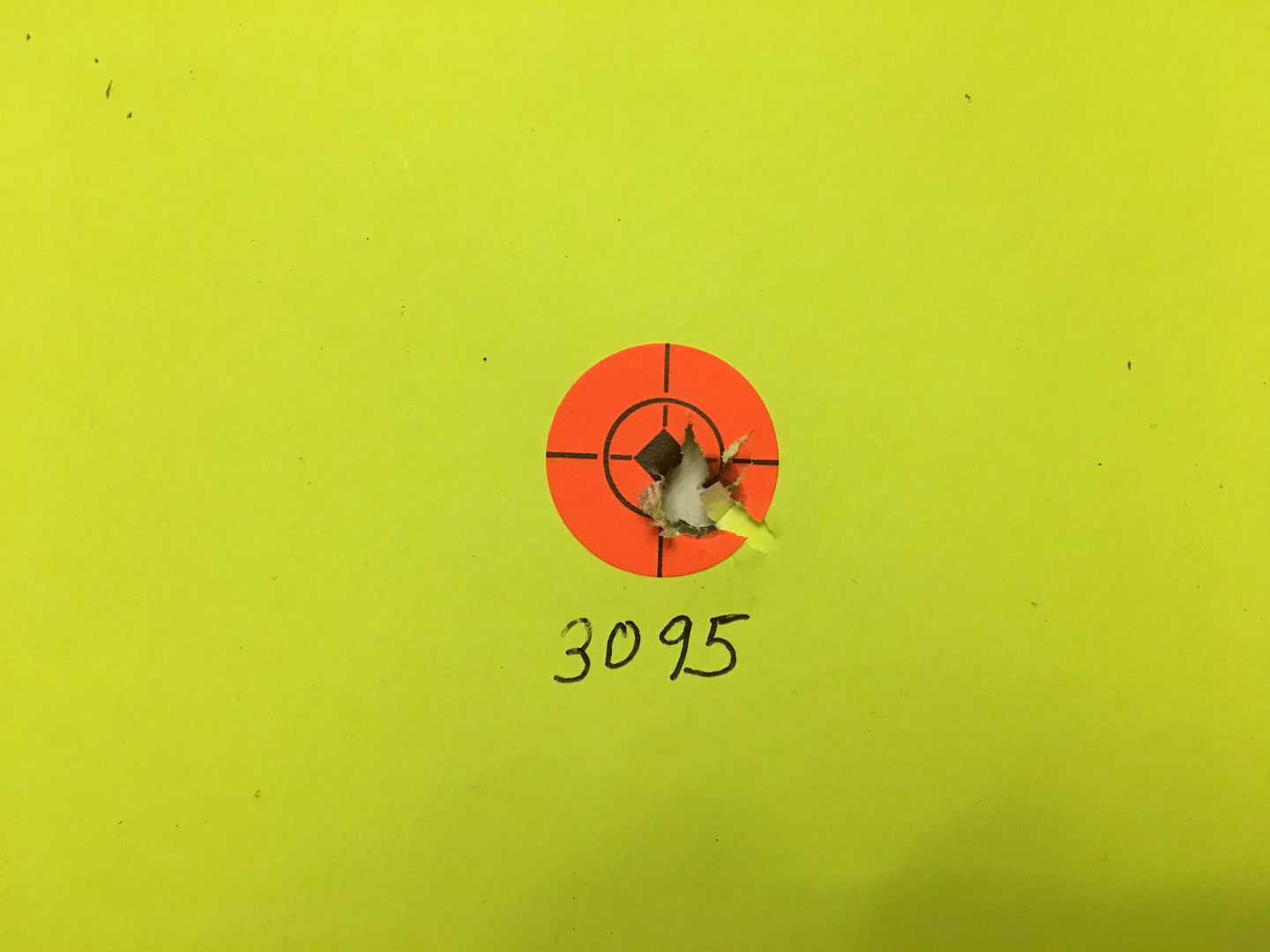

Very easy to hit 3200 plus fps but the accuracy will suffer. I started at 132 gr, went up to 134 gr, then my accuracy increased as I dropped down to 130 gr.
Cheytac brand 350 gr Bullet
Retumbo 130 gr, 3095 fps (best accuracy)
Federal Magnum Primer

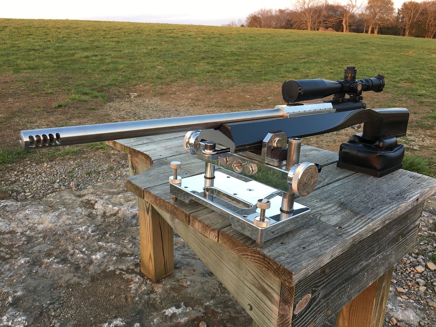

Bartlein 10 twist, 1.450 straight, no taper
Bertram Brass ( I have new Peterson brass now )
NF BEAST Rifle weighs 40 lb
Stiller TAC action
Scoville stock
Ryan Pierce BRAKE
Initial testing was from 132 to 134gr. Too hot. Accuracy improved when I dropped to 130 gr at 3095 fps
Dropped her down and groups tightened
