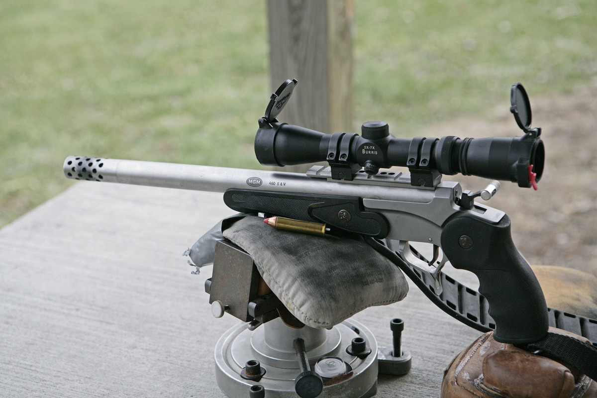

Pretty anemic for a rifle, my encore is 14" uses a 460 S&W, and 250 grain SST's plastic tip bullets with a load of 39 grains of 4227 shoots 2560 fps. But Find for deer with a 200 grain FTX, plastic tip bullet, but heavier jacket than the SST or the 250 grain plastic tip, with 51.5 grains gives me 2786 fps.

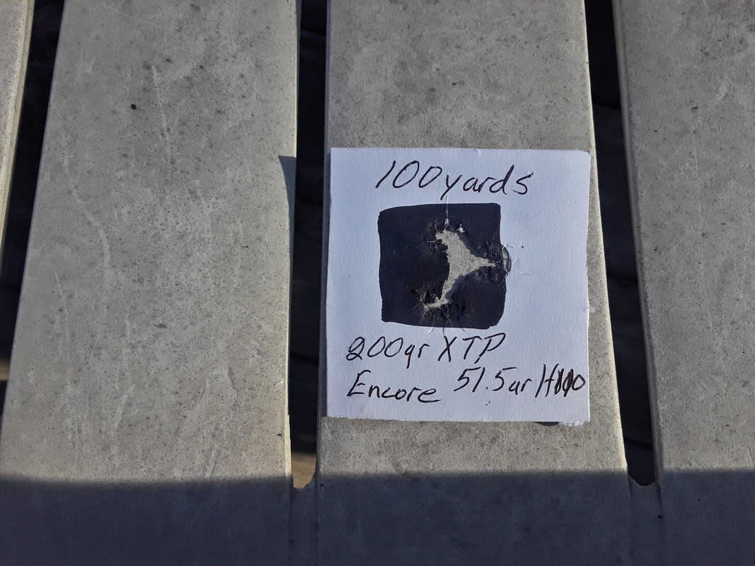

But not only put a priority on caliber, it has to be accurate, if not it really don't matter! 3/4" at 100 and keep em under 2" @ 200 with the 2x7x Burris. The targetb is labled wrong, the bullet is the FTX, much tougher than a XTP, made strictly for the 460 S&W.
Set that 1.25" high at 100 yards, and it's dead on out to 200, only about 6" at 300 yards, 326 is the longest shot I've taken whitail at with it, and it dam sure wasn't lacking. I've never recovered a bullet, always complete pass thru's.
