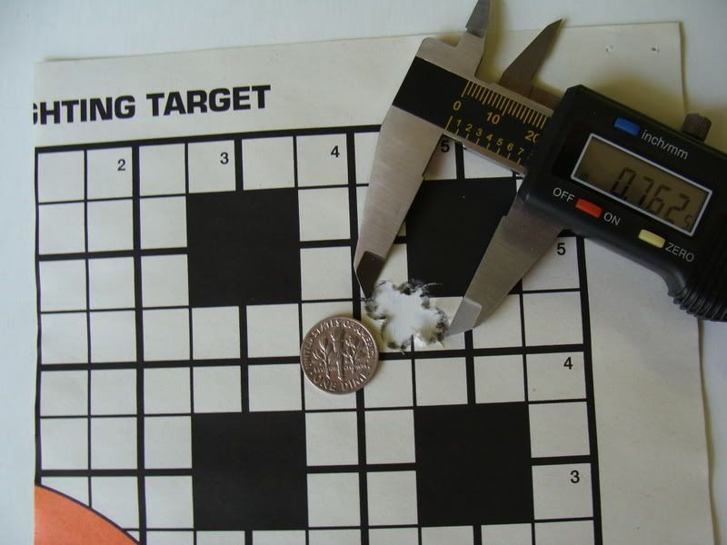

Alright, I guess I will be the first to chime in on accuracy potential of the 338 L. I have done a lot of bullet testing both at short range (200) and longer range (1000). I just am not experiencing this flier phenomenon you are describing.... so here are some tiny groups with the 338 Lapua. This is not a bench gun either. Its tough to shoot. They were all shot at 200 yards. One of the groups measured .340" outside to outside. It also shoots ridiculous groups at 1k. It had 20 shots while tuning seating depth, and all 20 were inside of 8".
Nice rifle and shooting. I have seen the fliers from time to time with the Lapua, and the only thing that is consistent is it happens with 300 grain bullets with slower powder. I cant explain it or find any other factors. Just my observations

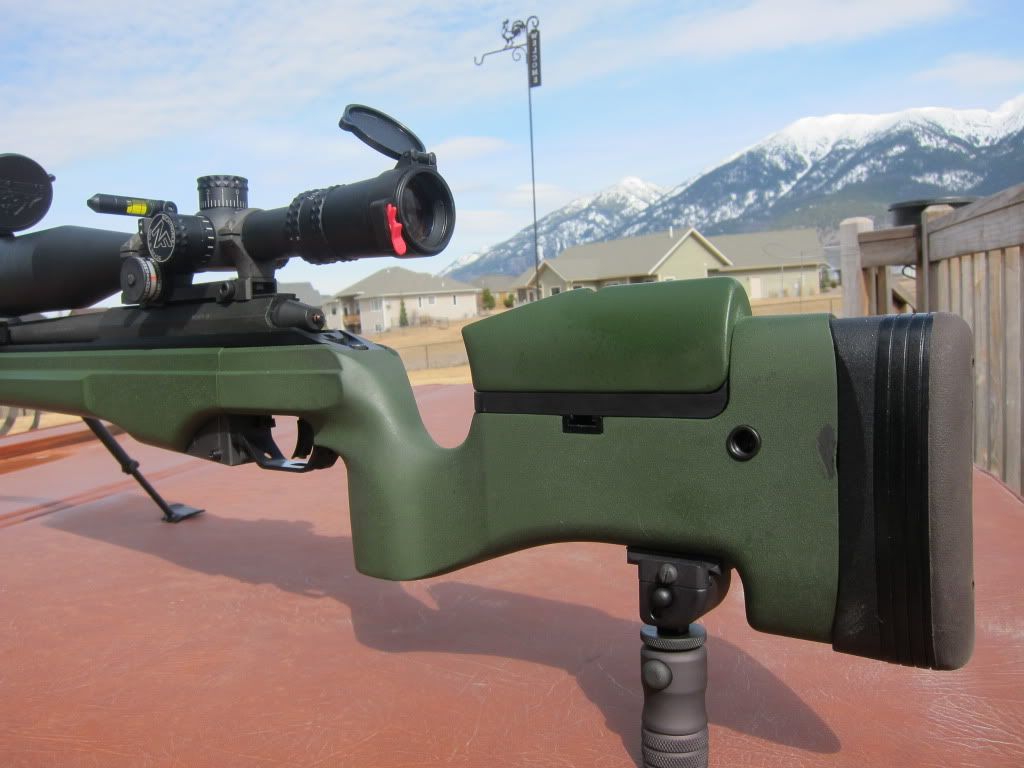

I'm the actual shooter you're talking about. But sorry my friend, I'm perfectly happy with my 338 Lapua. Flyer! non existent with my rifle. If ever there was one, I attributed it to me not the rifle.
20 shot group at 1000 yards.
Typical 5 shot group at 100 meters.
I think the proof is in the pudding, I am not saying anything bad about the Norma Mag as I am sure it is very good, I for one like Norma brass very well, however to say the .338L has flyer issues, Desert fox has proven this a myth, as he was able to do this awesome 20 shot group, just think what he could have done with a solid bench and a high dollar rest and bag setup, congrats Desert Fox, job well done.

Nice groups fellas :) I never read anything about fliers with the 338 lapua, i was just agreeing with what I had read about the Norma being more forgiving with load development. But that's just what I've read from folks with experience using both. I have no real life experience with either, but it sure is obvious from the groups above that the lapua is a serious long range round ;)
