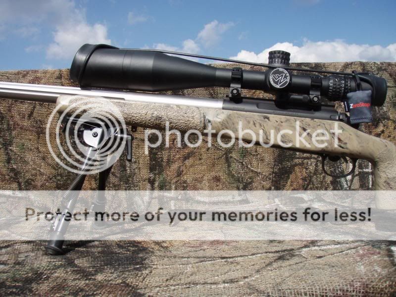

I've built several based on these components.
Stiller/Tooley action, Wby 30-378 mag box and Rem BDL floor plate.
That gets you one in the chamber and two down.
