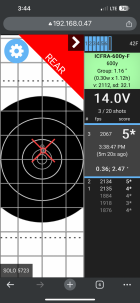

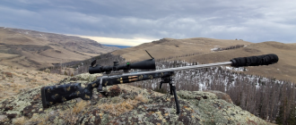

Alex built me this 338 IMP this past fall. 26-inch bartlein barrel with 9.3t, sendero contour, Bat HR, Mcmillian Carbon A3. Rifle, scope and bipod come in at 12.3lbs. I'm shooting the 300 grain bergers at 2930. This one is fun to shoot and hammers. The target picture was just at the end of my break in period (150 rounds), each shot was taken 5 minutes apart and with a little wind. Vertical was rock solid from 1,000 yards.
Very nice rifle and a great shooter!! A3 is an awesome stock.

With the suppressor the recoil is very manageable. With a good bipod and level shooting position I can spot my shots. I'm using the thunderbeast 338 ultra suppressor so that is adding 1 pound. It's a very enjoyable rifle to shoot and extremely accurate. My buddy also has one of Alex's 338 improved builds as well. Both rifles are excellent and very accurate. Both are used for elk hunting where we are shooting 400 to 800 yards.
We did set up a target at 1 mile a couple years ago after we filled out our elk tags, hit an 18 x 30-inch target 5 out of 7 shots with these 338's.
