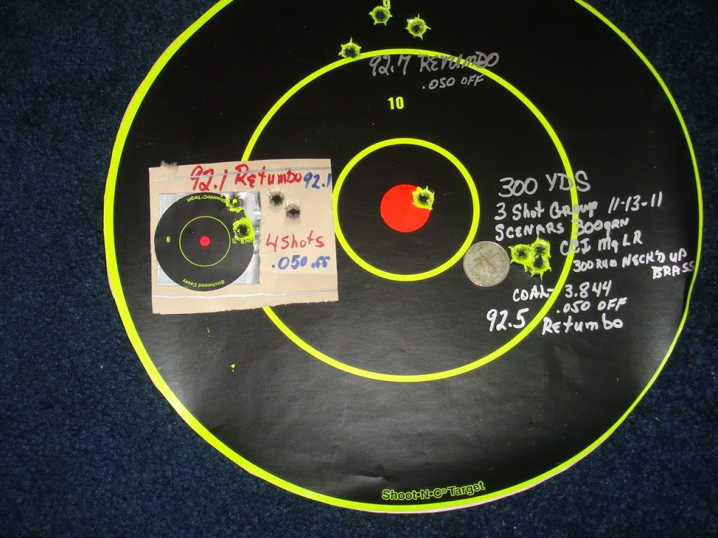

In my gun, 92.5 grains of Retumbo, .030 to .050 off the lands with the Secenar will shot .250 groups when I do my part @ 300 yds. I can send a picture of my target.

Mine is a 28in 1-10 Mcgowen barrel it has around 30 rounds through it so far, it like 93.0gr of H1000 with a CCI250 and 300gr Berger OTM seated .010 off. My ES was 6 for three shot group 2803, 2803, 2809. I have some testing to do with seating depth still but so far it looks good all groups fired from 89gr-94.0gr H1000 were all less than .75" at 100 yards so it pretty much liked H1000 and CCI250's. I will try seating depth .005 increments untill i hit the sweet spot. I am still breaking the barrel in, first 10 shots cleaned after every shot and then cleaned after every three shots. after about the 15th shot it almost stopped fouling no copper. I am pretty impressed with the Mcgowen barrel for how little I paid for it.
The above picture . . . I also have a McGowan barrel, put 3 300grn Scenars inside of a quarter at 300 yds!
