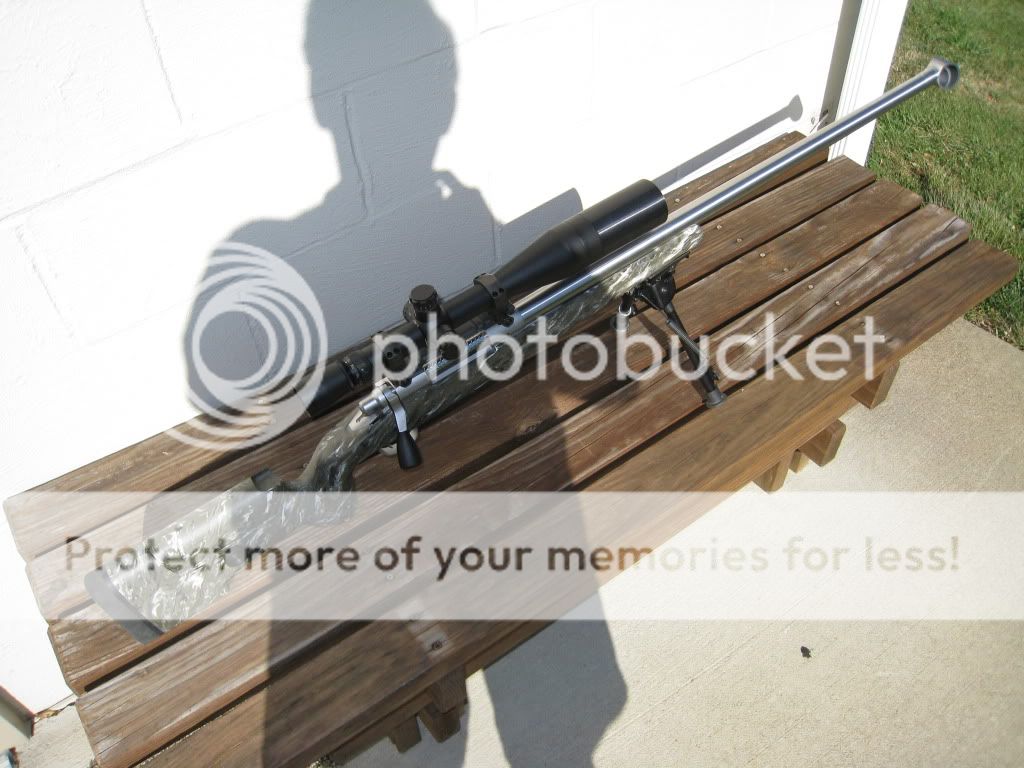

I've got 2 of them. Here's my latest:
Savage target action(from the original F/TR)
Base Near Mfg. 12 MOA
Alphamount Near Mfg
Scope S&B 5-25x56mm PMII P4LF
Stock SSS LV/T, ajustable cheek piece, front rail for bipod, bedded with Devcon 10110, Hiviz Xcoil pad, epoxy/Tru-oil finish
Barrel 338 Edge Brux 30", 1/9.5 twist, Near Mfg muzzlebreak.
Barrel Savage 308 Win original 30", 1/12 twist
Barrel 6mmBr Norma Brux 30", 1/8" twist
