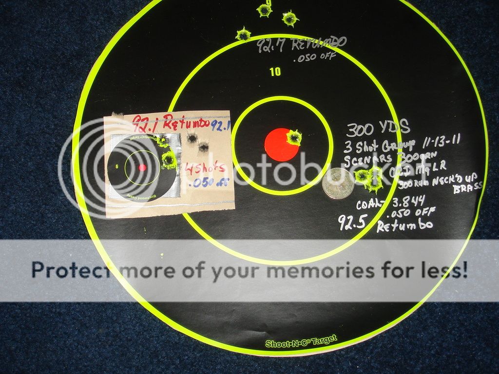

300 grn Scenars, picture speaks for itself.
Hard to believe a few tenths of powder makes a difference.
