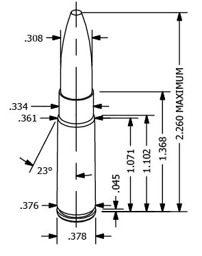

338 ARC & 300 BLK for hunting
While looking Over Hornady Ammo lately I noticed 3 of there 300 BLK loads are listed as hunting loads while neither 338 ARC loads are listed for hunting.
One of the 300 BLK hunting loads was the 190 gr SUB-X while the 307 gr 338 ARC SUB-X load was only suggested as a target load.
Anyone care to float any ideas why the 338 ARC SUB-X offering is not being marketed as a hunting load while the 300 BLK SUB-X offering is being suggested as a hunting load?

Where are you seeing 338 ARC load data?
Do you have dies? I've been waiting 5 months on a back order and haven't seen them in stock anywhere.
I Have yet to see dies or load data for the 338 ARC. Suppose I am only exploring the viability of either the 300 BLK or the 338 ARC as a subsonic hunting cartridge. Trying to warm up to the idea & thus far I have not warmed up to the idea of subsonic anything for hunting, as much as I want to I am thinking I may just stick to super Sonic loads for what I do.
