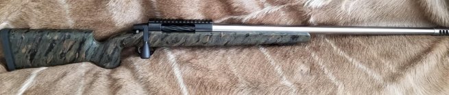

Its just shy of making it to 2k super sonic. The 338 Lapua imp and 300 Norma imp seem like the minimum. I have some different barrels speced out to see if I can find a little more velocity, but I still think the 338 Norma Imp will come up just short. It would be an awesome mile gun though. Below is a pic of the rifle Tom is tuning up now. a.jpg
