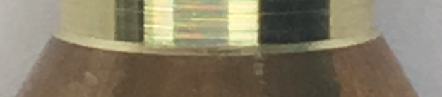

33 vs 43 degree cutter
43 degree on a 40, per K&M, trim to the Exact same length for proper brass flow.
You did go a bit to far into the shoulder.

I find you get better control of the cut into the shoulder if you use a cutter with a sharper angle than the parent case. For the 6BR parent case (30 degree), I use a 40 degree cutter. YMMV.

If you can feel the shoulder cut with your finger nail, it is too far. Here is some 30-06 Lapua brass I made into 25-06 brass. I always use a steeper cutter than the shoulder angle. Keeps from cutting into the shoulder as much.
Jeep2 god move on turning the necks on 25-06 brass. I hear about people necking down and not turning necks and it may work some times but I tried it years ago and had big problems. They look great and you know they have enough clearance to work without an over pressure.
