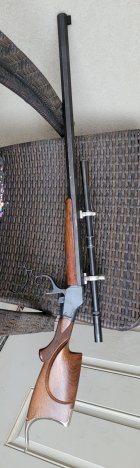

Very nice looking rifle. What do the cartridges look like? Sharp ackley shoulder or more relaxed ? Also are you shooting cast bullets or jacketed?
I headed out at lunch today with a few bullets to get some initial load data.
I used H4227 and started at 14.5g and went up to about 16g.i was only getting about 1.5" at 100 yards.i had 5 of the 249g bullets left so I bumped it another grain and my last 5 bullets did this.it was either lucky or that long bullet just needed more powder.next session will tell the tale...
All bullets breech seated about 1/32 foreword of case
Very good work! What is the twist rate? I have a Hepburn chambered in 32-40 Win that will get it’s maiden voyage very soon.
I took out the same load this evening.i shot a warmup group them these three 5 shot groups at 100 yards.i got one really nice and two so-so.
The general load seems ok.now it's
time to put on the 20x unertl and play with breech seating depths powder charges and primer types.
