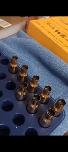

When you mechanically neck up from 6 to .30, the 'lump' at the base of the new neck measures right at .337. Trying to do a 'no turn' 30BR on mechanically expanded 6BR cases.....the neck diameter would have to be large enough to accommodate the 'lump'.
The 'lump':
