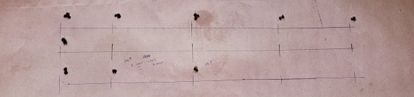

Here's a good representative example on a final load development after roughing in powder, seating depth, then fine tuning powder, and this target is finally only final seating depth and bushings.
Top line and the one shot on the second line is all the same bushing, moving in seating depths of .002.
3rd line is same seating depth (as the corresponding above it) with different bushing .001 difference. You can quite easily tell the different that it makes. Everything but the one marked with 5 shots were 2 or 3 shot groups until it started printing one hole. Then went one beyond that to see where it starts to come out of tune.
I keep track of all the targets through the process. This 5 shot group and the ones on either side mirrored exactly my rough powder/seating target from months earlier with 30 degrees difference in temp. Vertical, into one hole, into ragged hole.
This is why flags are important. As mentioned, even at 100 yards, a load that will shoot very small can be blown a whole bullet hole out with a wind change and you'd never know.
