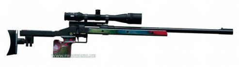

I first posted my question in Januari, meanwhile I decided to buy a complete semi-custom rifle in 6mmBR instead of converting a rifle. Gunmakers with the knowledge to replace a barrel on a precision rifle are hard to find and very expensive here in europe. There is very little rebarreling in continental Europe, people sell the rifle and buy a new one.
A bougth a 6mmBR Keppeler sporting rifle for a reasonable price,2300 euro). You can see it at the website: http://www.keppeler-te.de/ . Keppeler is a small factory in southern Gemany, building rifles in a semi custom way. The founder Dieter Keppeler has left the company now. He worked for some famous German gun factories,Walther, Mauser) as a designer before he founded his own company. He designed the Walther WA2000 semi auto sniper rifle in the eighties for instance, you sometimes see these in movies like in one or two from 007.
Once I've shot my Keppeler properly I'll report my opinion on this rifle here. I only shot it once until now, but the results are very promising, a quarter moa 5 shot group @ 100 meters.
